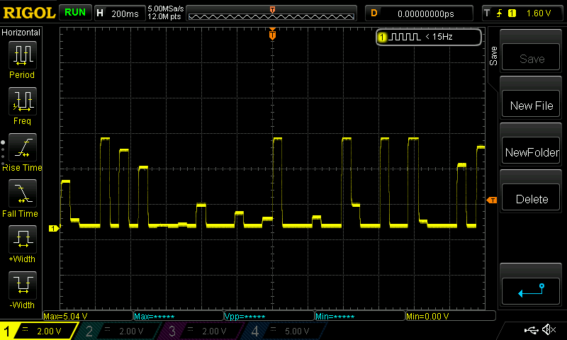

I’ve built a SLC free 2 onto a custom speeduino board I’ve designed to try and convert a F6A kei truck to fuel injection. For some reason the output halfway works, but the majority of the time the output is much lower than it should be. This picture is in free air, but I can verify the maximum output voltage does follow the actual AFR like it should using a propane torch.
I have a few S2OEM boards, didn’t use one due to space constraints in the cheap china ECU enclosure, but all of the LSU 4.9 sensors I have work on S2OEM boards just fine. All purchased from 14.7, laser engraved. The supply voltage, both the 5V and 12V are steady with no spikes or dips. I bought a PSOC miniprog and I’m using PSOC designer 4.3 to program the chips, it seems to work and verifies like it should. I’ve made no changes to the prebuilt hex code.
Does anyone have any recommendations to fix this issue?

I sent you that email, but I finally figured out what I did. Instead of using 100nf filter cap for the processor I used a 10nf cap, must have been browning out. I guess I accidentally swapped the reset pin cap with the 5V rail. I feel pretty dumb for not finding that sooner…
