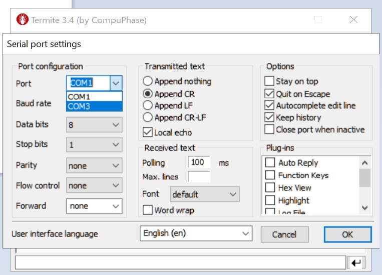

Before you flash the firmware,open Termite. In settings, make sure the serial port shows up.
In the above example the serial port for my Spartan 3 is COM3. Close Termite, then proceed with the firmware update.
