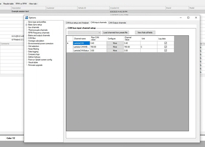

Can you see the wideband’s output in yourdyno’s, options, CAN Bus, analyzer after setting up your inputs from the Spartan?

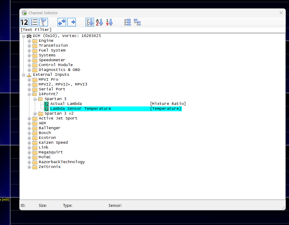

Than, Did you add the channels to VCM scanner under the folder beneath serial “14point&”

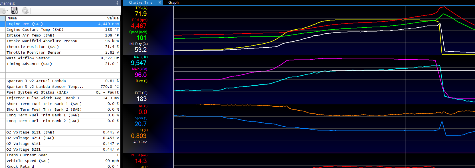

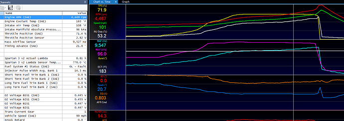

I have the one spartan device on the yourdyno’s CAN bus and I can see it live on yourdyno and hp tuners during the runs
This is a part throttle run I did last month and it matches the dyno graph pecisely

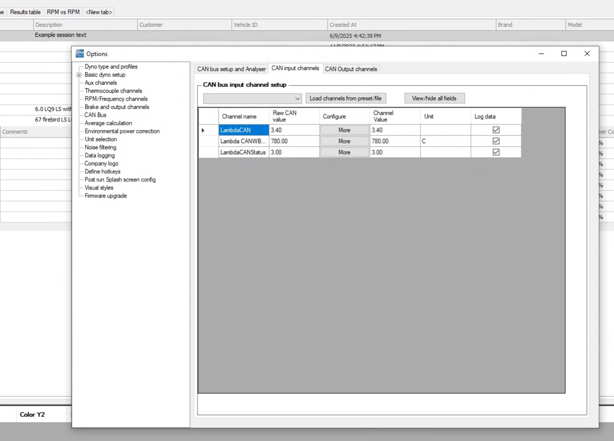

No, under the “Can input channels” in yourdyno I dont get anything from the Spartan.
When you select like you show in VCM Scanner, I assume that is for Canbus communication?
I dont get any response or signals.
