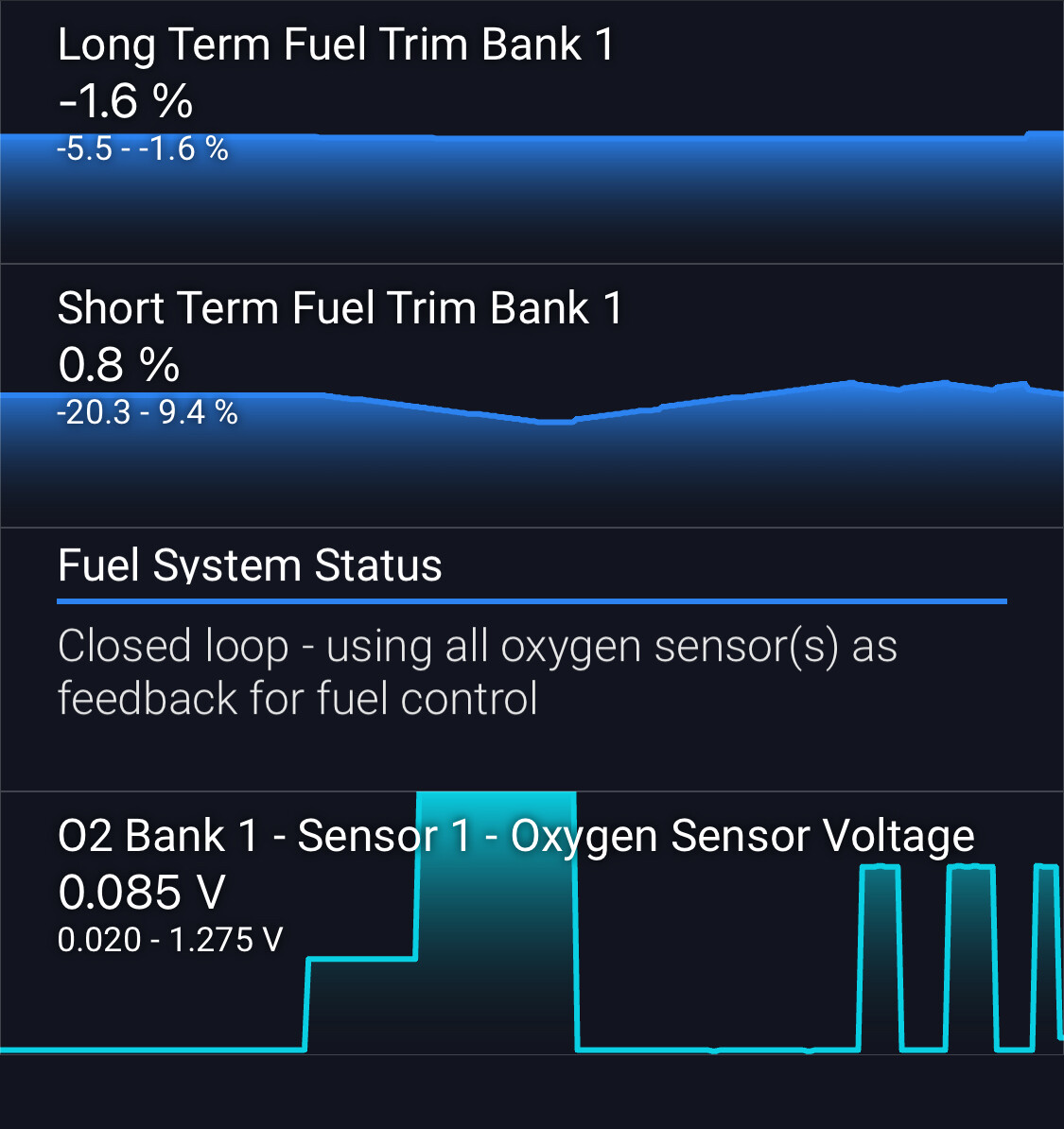

Heres a quick chart from my OBD reader. The whole time the sensor is “frozen” the short term fuel trim is being dragged down, and as soon as it unfreezes the trim starts to recover and the engine idles correctly again.

Thank you for the reply. I’ve been logging voltages on the different pins, and Im seeing odd behavior on the narrowband emulator. The wideband pin properly outputs lambda = 1 during warmup, but the narrowband pin also outputs 2.3V? If this was the 5V output that would be correct, but the proper narrowband lambda = 1 should be 0.45V right?
It’s only during the warmup cycle. As soon as the sensor starts reporting, the narrowband returns to correct range. Is this a bug on the firmware version I’m on? Thanks.
Yeah, with gauge disconnected, powering on the device has the following behavior:
First 5 seconds:
High perf output=1.67V
Std output=0.47V
5-10s:
HPO=3.34V
STD=0.47V
10s+ (until sensor warmed):
HPO=2.35V
STD=2.33V
I flashed the Spartan back to version 1.08 and it doesn’t do this. It stays at 0.47V throughout the entire warmup.
