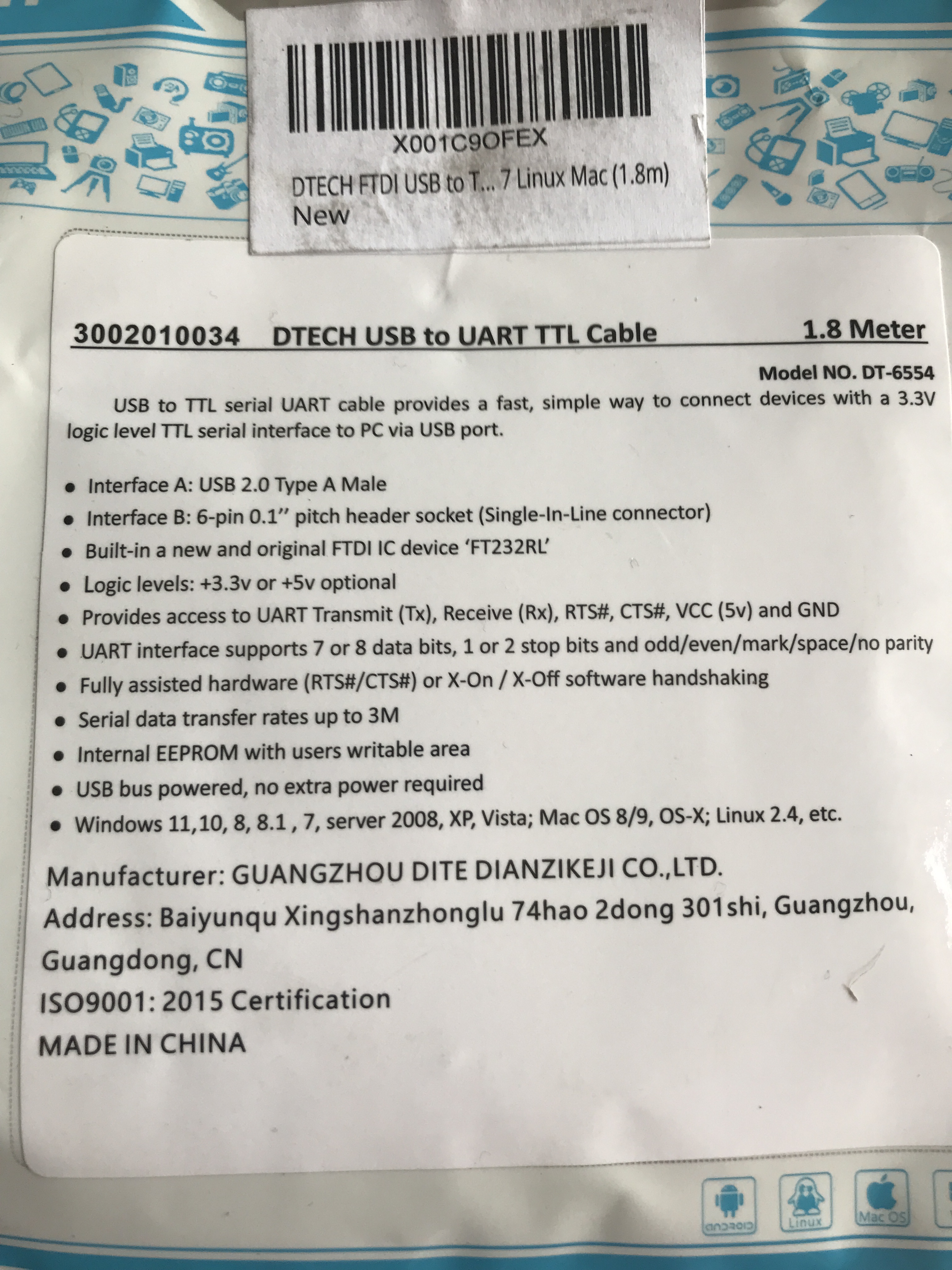

Thanks for quick reply. Attached is link to Gearmo USA-FTD12X c/w FTDI chipset.
You need a different type of converter like in this thread, UART to USB converter
Should it be 5v interface as this cable doesn’t transmit and data…
Thanks
