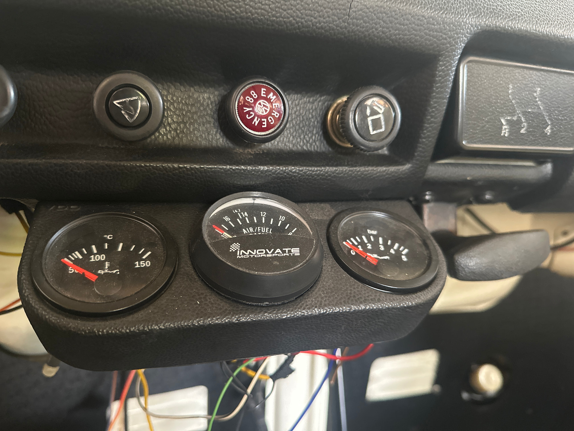

Hi all, I have a nice looking analog gauge in a car where previously an old innovate lc-1 was installed.
Is there a possibility to program my Spartan for it?
i think it needs this output; “linear output between 0V and 5V for an AFR of 7.35 to 22.39.”
I have the digital gauge from 14.7 as backup, but does not fit the rest of the car
Buy this, UART to USB converter - #13 by toalan
Read section 6,7,8 of the Spartan 3 user manual, https://cdn.shopify.com/s/files/1/0189/1312/files/Spartan_3_v2_User_Manual_a3aca744-bca6-4148-8214-e93e0c07858a.pdf?v=1768973819
Send the serial command: “SETLAMFIVEV1.52” and “SETLAMZEROV0.50” without the quotation marks.
