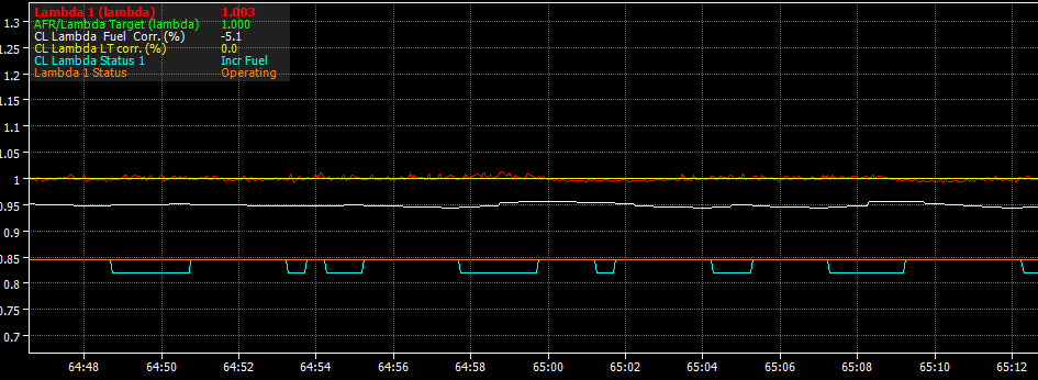

This is before the problem appeared:
(forum won’t let me post two embedded pictures :roll_eyes:)
Very stable AFR with a smooth CL control and uniterrupted lambda value

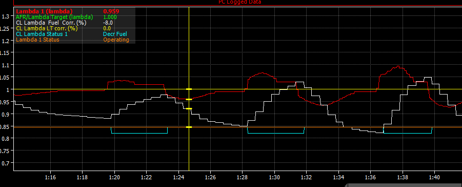

This is after the problem appeared:
Lambda sticks at fixed value for up to 3 s and of course CL control overshoots and when lambda “unsticks” all hell breaks loose.
The CAN hardware and software configuration is exactly the same. The car did sit stored for a few months though until I topped up the battery and fired up the engine again.
Spartan firmware is v1.10. I have tried to go back to the LSU 4.9 and update the configuration but the problem is still there. Also tried a couple of changes in CAN configuration, resistors, etc but it’s all the same.
Is my Spartan dead? Any test I can make (such us get a direct lambda reading over USB to see if it sticks?
