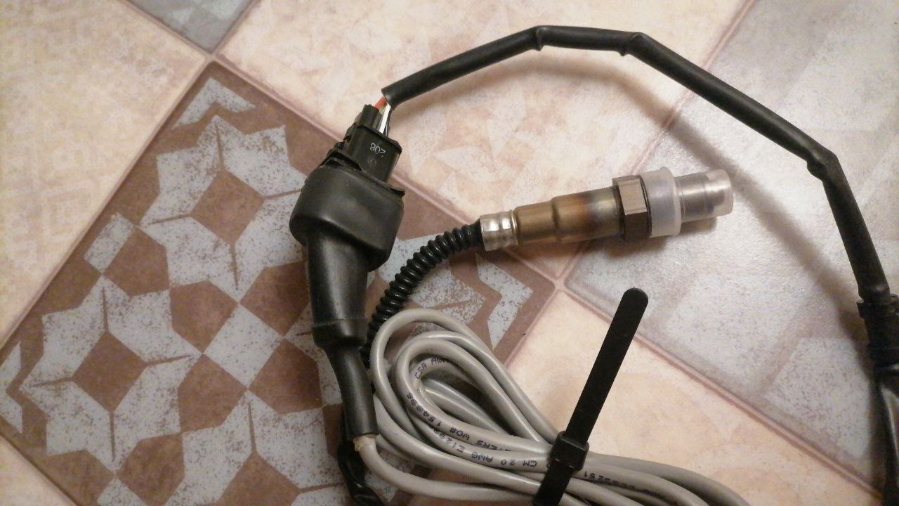

I got this delivered somewhat ~15 years ago(!?). It was waiting all this time in a table. Unfortunately, I can’t find any info about this product on the website - what product is this? What’s the pinout? (it looks like an LSU4.2 sensor with a controller hidden inside that black thingie?). Hope, someone could help clarify..
It is a Spartan Lambda Sensor, https://cdn.shopify.com/s/files/1/0189/1312/files/Spartan_Lambda_Sensor_User_Manual.pdf?1955
